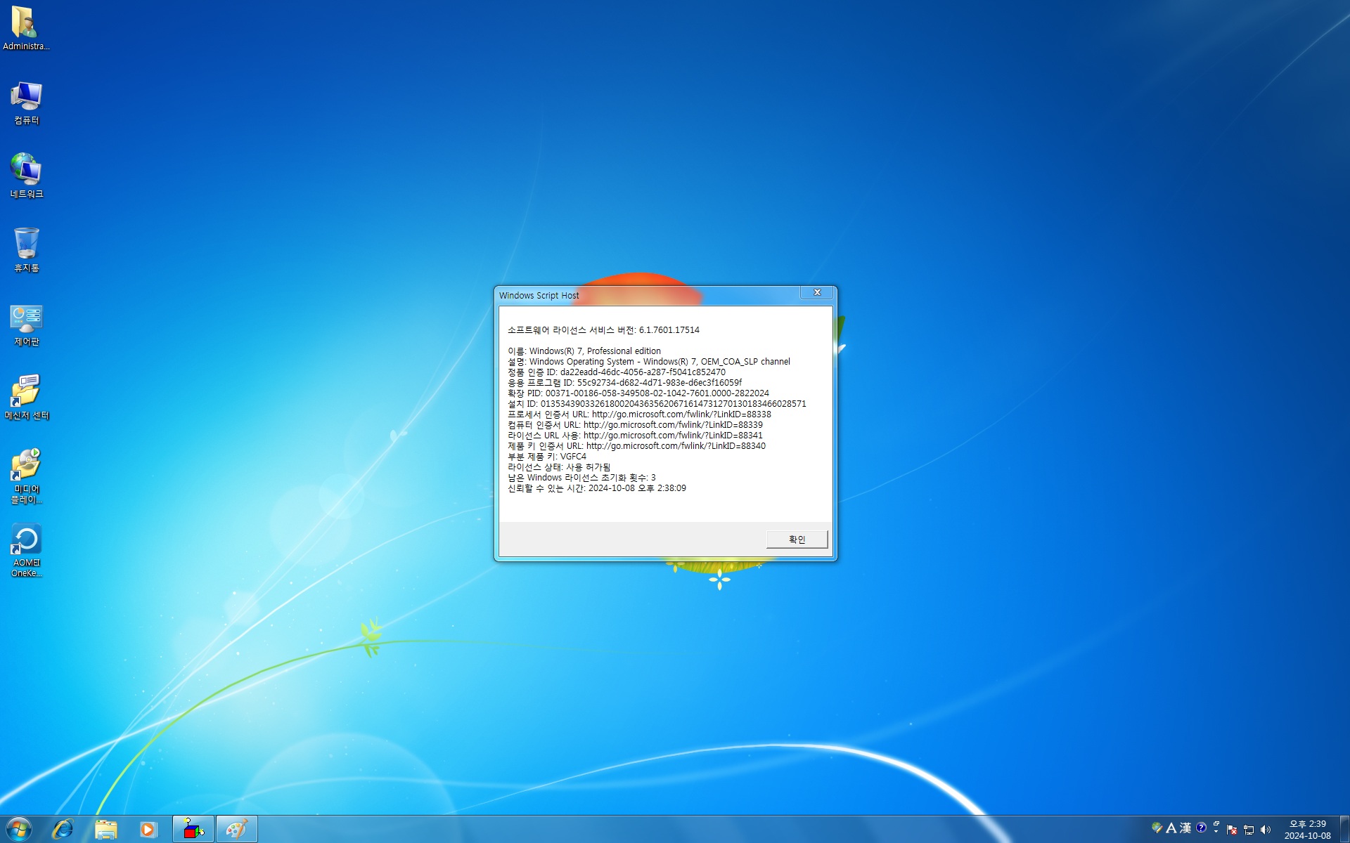

| To check the activation status, open an elevated command prompt window as administrator, and run the following command:slmgr /dlvThe dialog box with the following details should appear: | |
| License Status: Initial Grace Period | |
| Time remaining: 30 days | |
| Remaining windows rearm count: 3 | |
